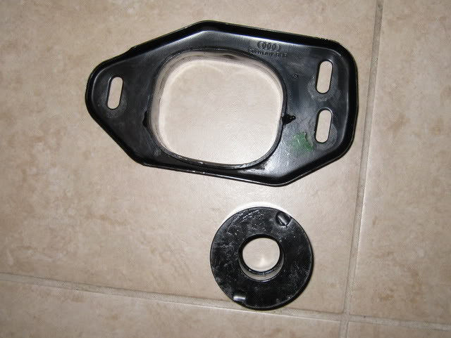

so i looked in the manual a bit and couldn't really find the part, but I am thinking that my 2.8 is missing the snub mount? Hopefully you can see it in the pic below. There's supposed to be some rubber for that snub to fit into the lock carrier with... right?

ya you're definitely missing it. how were you driving like that lol. how's your car coming along?

Yea theres a rubber mount. When I did my timing belt i took off the front and my was ripped in pieces.

Might want to check your other engine mounts since they have been absorbing the flex for who knows how long.

Probably has been like that for at least 44k miles since the last timing belt job. Lame! I ordered a new one from PureMS along with a new coolant tank. I found a few other things while i was in there... someone had use too long of bolt in the AC condensor attachment and put a pin hole into the radiator that was plugged by the bolt itself. JB weld to the rescue... also the serpentine belt was worn, and its tensioner sounds like it's bearings are getting dry. Good things to find early!

Ok so I ordered a mount from PureMS and maybe I ordered the wrong one? It doesn't really fill the hole. Is this normal for the stock bracket and mount??
