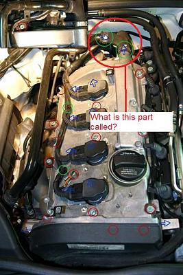

I'm having trouble with my motor!!! I keep on getting code P0171 - System too Lean (bank 1) and sometimes I get code P0170 - Fuel Trim. Could this be caused by the defective part below? What is this part called? I've checked all hoses and the MAF was replaced not too long ago.

here is the one i got to replace mine
http://www.034motorsport.com/product...ducts_id=18010
i belive that it is called the "F" hose

Yup, replace it.
Breather hose, T hose, F hose, whatever you want to call it, that's your issue (or one of them). Those breather hoses collect oil and collapse and create vacuum leaks. Follow it all the way down and you'll find a metal section that goes into another plastic section, which goes into the block. Check all of those for cracks. Follow the breather hose the other way towards the airbox. You'll find a series of connections made of rubber or plastic. They are all prone to collapsing or cracking.
If your 1.8T has 80K miles or more, these breather hoses can all become suspect. If any of them collapses or cracks, you'll end up with lean fuel trim codes.
