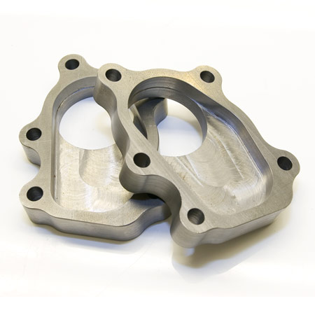

That will not work for him since that bolts to a 4 bolt exhaust housing. His turbo has a internal wg which is why it has a 5 bolt, the outlet is oval not round.
If you need one let me know. Here are a few options.
Normal 5 bolt flange
Mild Steel CNC 5 bolt flange
SS 5 bolt flange
5 bolt flange that has a round outlet
SS 5 bolt flange with 3" pipe welded on
Mild version of that flange
This is a 5 bolt flange that goes to a Vband.
