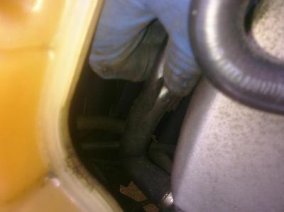

I found it today! An air leak! One of my hoses by the intake has a huge hole in it. Hey they guy at Advanced Auto couldn't help me ID this hose, do any of you have an idea?
This is the hose coming off the back of the intake runs along and kinda under the coolant reservoir.

Old May 26, 2010 | 03:18 PM
CCA4's Avatar
Posts: 7,588
From: NW PA
Where's the other end of it go?
Old May 26, 2010 | 03:28 PM
joenelson7687's Avatar
Joined: Feb 2010
Posts: 1,407
From: Baltimore, MD
Mine broke too! It took me for ever to find it. I think it has something to do with the PCV system.
Old May 26, 2010 | 03:29 PM
Joined: Feb 2010
Posts: 1,407
From: Baltimore, MD
It was hard as hell to find because it broke right along the seam of the bend...tricky bastard.
Old May 26, 2010 | 03:40 PM
mikekey's Avatar
Joined: Nov 2009
Posts: 911
From: Saint Petersburg, FL
So did mine, I visually inspected everything a couple times, it wasn't until I decided to squeeze everything not just look, that I finally saw it.
Old May 26, 2010 | 07:48 PM
mikekey's Avatar
Joined: Nov 2009
Posts: 911
If anyone can please tell me what the hell this is, the duct tape is where the giant hole is.
Attached Thumbnails 9 Trouble Codes :(-dscn1369.jpg
Old May 27, 2010 | 12:46 AM
Joined: Feb 2010
Posts: 1,407
From: Baltimore, MD
Its part of your PCV system.
Old May 27, 2010 | 09:07 AM
mikekey's Avatar
Joined: Nov 2009
Posts: 911
I figured it out last night thanks to the folks at Audizine. It's called the L hose for the vacuum suction pump.
http://www.ecstuning.com/Audi-B5_A4-...oses/ES251440/
