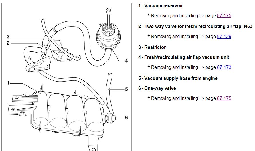

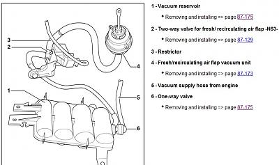

It goes to the vacuum accumulator that's between the HVAC box and the firewall. I believe that's only on pre-facelift B5's.Originally Posted by aa-4
The line runs under the heater core lines through the firewall and into the car but seems to disappeare. Where does it go? Cause i still have no heat... And what could i possibly have missed?
The bad news? You won't get to it unless you pull the dashboard out.
The good news? All the vacuum runs (what is it with the German love afair with vacuum?) is the fresh air/recirculation door behind the blower motor. It has nothing to do with temperature.
Here's a pic:
thanks for the diagram... well guess ill replace that vac line when i do the core. ive had a new core just dreading tearing my dash out. but it dont seem like i have a choice at this point.
