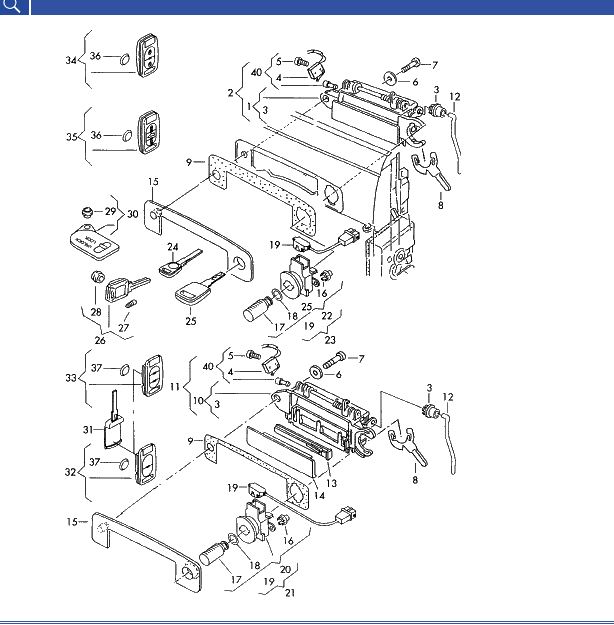

I asked a tech that's been around a while in our shop. Turns out it's the 97 car that has the really thin 2 button (#30 earlier style 97) remote that can't be updated to the one piece flip style key. And the reason is the frequency of the remote is different than that of the flip style remote. The thicker remote (#34 or 35 either one) from the 97 year cars vin 8D V 000 001 and on can be updated to the one piece flip style key and remote combo.
