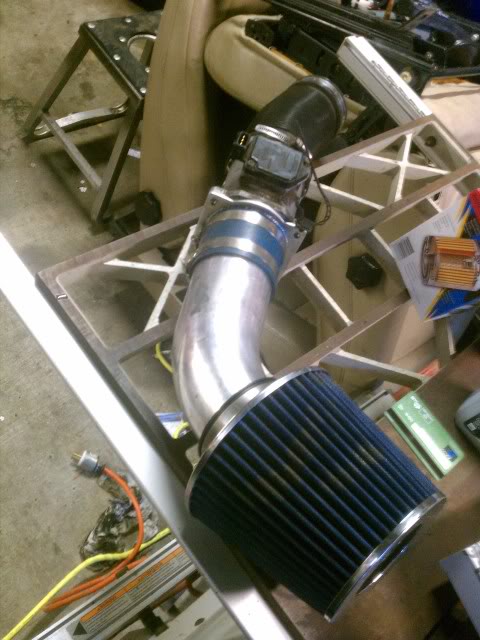

here's my Hot-air-intake

Nice job on that abnormal.
Audi_b5, abnormal's intake will sound nicer for sure. If you had time I'd build a box around it or just heat sheilding sealed to the hood and engine bay with weather stripping or similar.
Some of the cone filters have a bell mouth/velocity stack shape near the adapter to the tube, which can reduce turbulence and therefore increase intake speed. People with the stock airbox can do this by putting a velocity stack near the filter box outlet, which does the same thing, but this also allows you to de-screen the maf, which makes a nice difference.

I tried a hot air deal with no MAF (pre-'99) and honestly it's mostly a sound thing in my experience. The stock A4 intake is actually super efficient for a factory deal. Nice setup though!

thanks, i just figured it would be a tad more efficient... and i know its not "cold" air, but it does the job.
