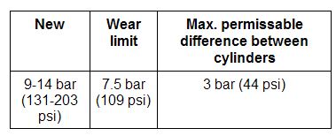

Well the passenger side has been running weird since I got it and I have always thought that it might have jumped a tooth when they did the timing belt as this is a problem for inexperienced "mechanics" and I don't know that they even did it right. These are not like fords and chevys most shops work on This car was a horror show when I got it but since all my repairs it has been getting a lot better. According to vcds the passenger side has been running lean during idle but evens out at higher rpms. I have swapped o2 sensors to make sure it wasn't a bad one but that had no affect. I have a constant misfire on that bank during idle and driving speeds it all seems fine. I have knocked out pretty much everything on the misfire list except new head gaskets, making sure the timing belt was done properly and rebuilt heads. I don't know if its an audi thing but I can hear clicking on the cylinder banks when running. I have always thought it was just the lifters hitting the valves during normal operation but now that its doing this I'm thinking twice about that. I am going to do a compression test as soon as I get another pair of hands to assist, that will tell me a lot more. Do you know what the compression range should be for the 2.8? I read awhile ago it should be around 80-85 psi but I'm not sure. The Bentley manual doesn't have much info.

One of the few advantages of digital Bentley is the search. But it is hard to find.
Your question about timing is a good one. You really need the tool to do it right. If you use marks, you won't be dead on. And if you use marks some other guy made, you're really throwing darts.
