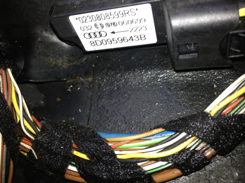

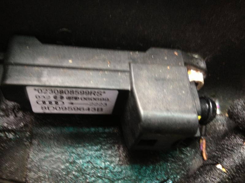

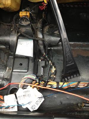

Us this the part

No. 8d0959643b is an air bag crash sensor. I'm not sure where it's located, but you want the central locking pump module way back in the pass side corner of the trunk. You have to pull up the carpet back there and find it down beside the frame rail there.
