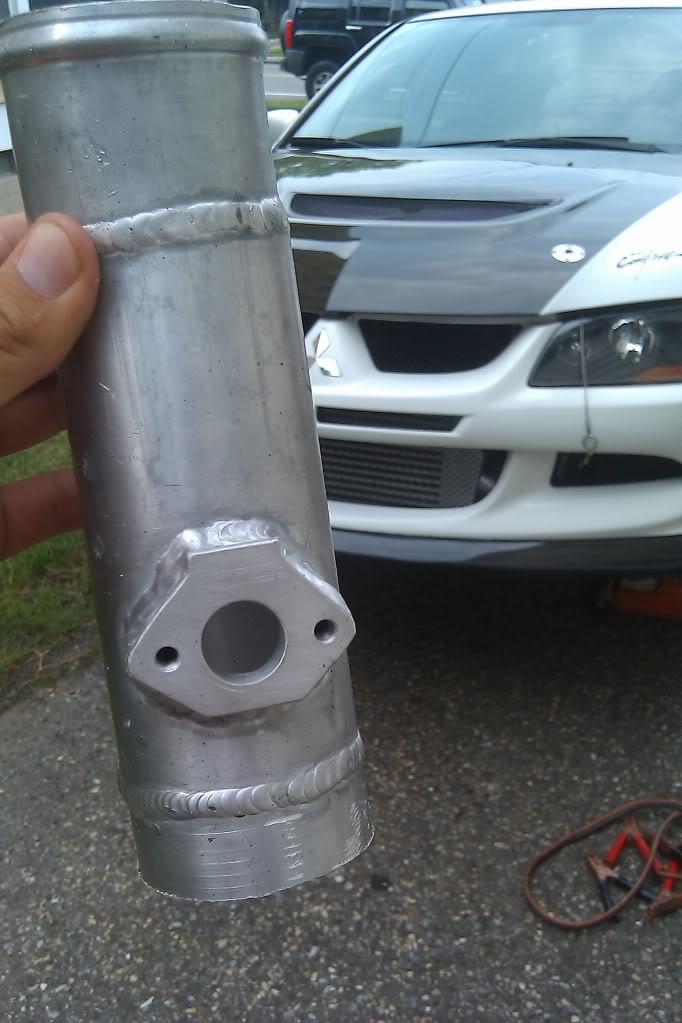

I have a map sensor flange on a piece of charge pipe if you want it. Pm me if so.
Evo not included.
Evo not included.
lol "evo not included" pm'd you.
