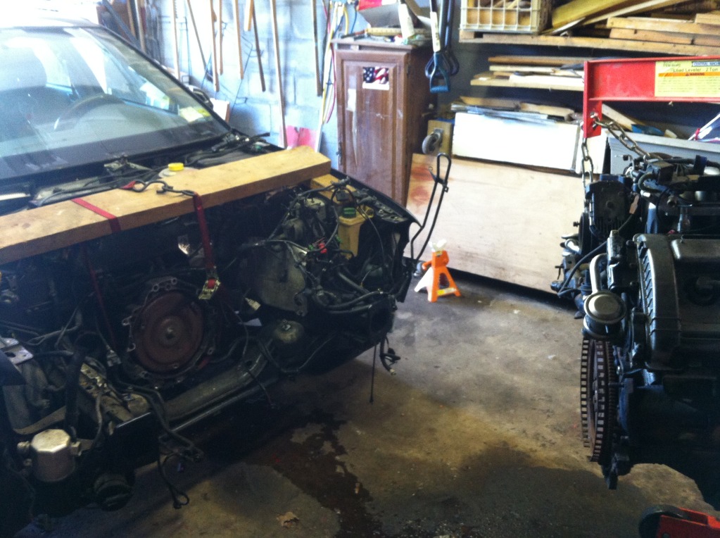

Got it pulled yesterday. Had to pull the car out so I could get the old engine out of the garage and the new(er) one in.
Putting everything back together now that's what I'm a little nervous about.. hah I'm just paranoid that I'll get everything together and forget about something stupid. haha.
