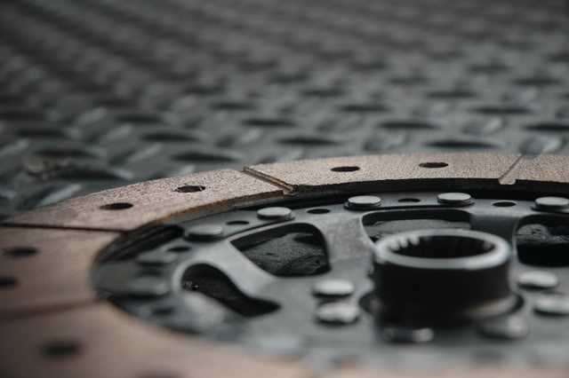

If you installed the disk so that the side of the hub that sticks out from the disk is facing toward the flywheel you are going to have problems since the center of the disk is now hitting the flywheel bolts. The correct way of installing a unsprung disk on a stock flywheel is so that the curved part of the center section of the disk where the splin is located faced toward the pressure plate.
Here is a picture of a 1.8t unsprung disk. The side you see facing upward in the picture should face the stock flywheel, this way the stock flywheel bolt heads do not hit the hub.
If the disk is installed backwards the hub of the disk will sit lower then the actual disk causing it to catch the bolts since the center area of the stock flywheel is flat putting the bolts at the same level as the surface area of the flywheel where the disk makes contact. This is why a sprung disk can not be used on a stock 1.8t flywheel.
