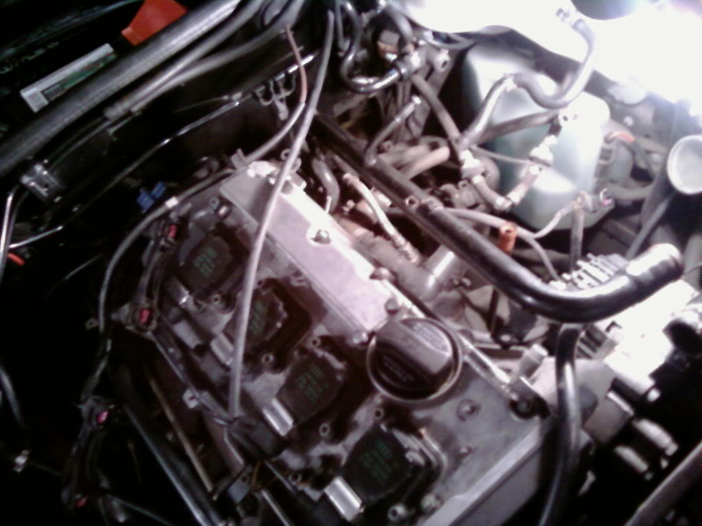

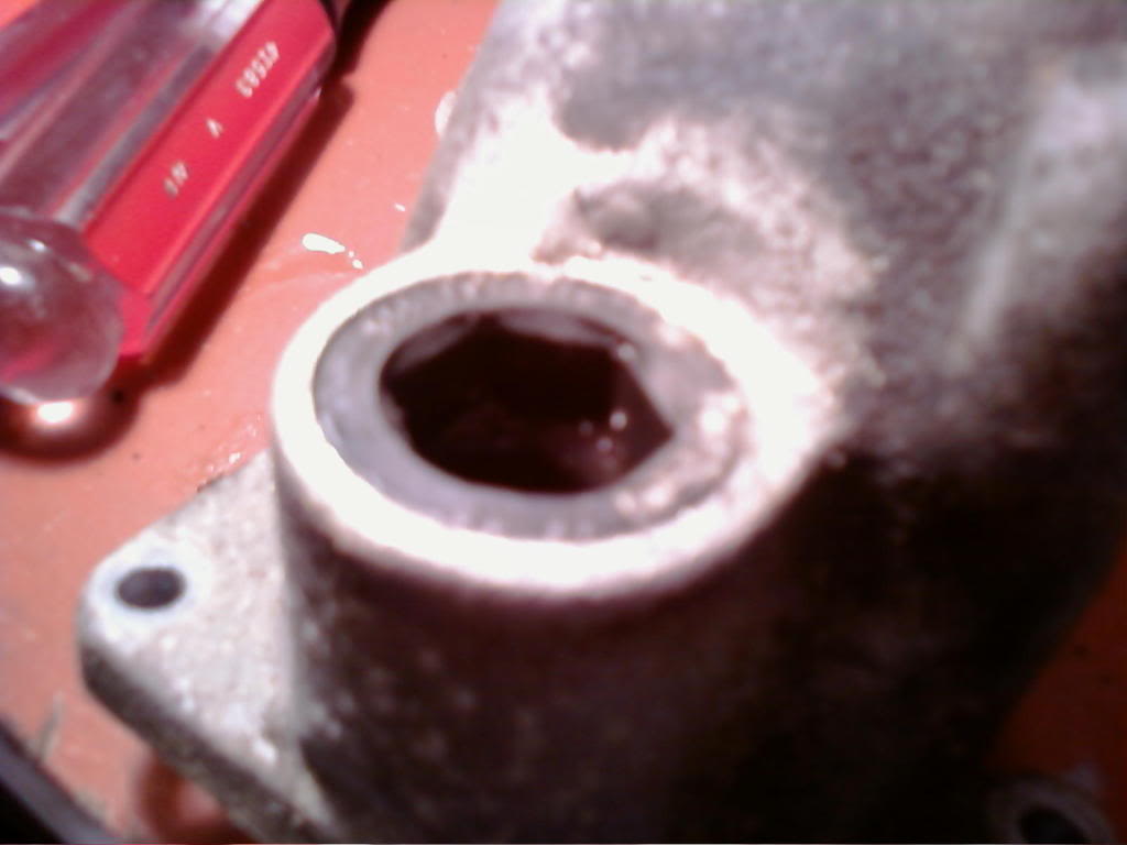

My friend is Experiencing boost leak from here, and we want to take them out and seal them up real well.

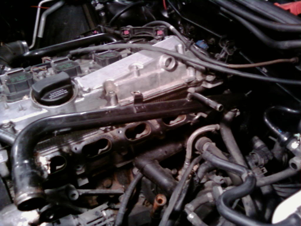

some shots of the bay

They tread into the manifold. You need a allen head socket that is large enough to fit into there or the special tool that is meant to take those out.

I would be really careful and make sure you do it with the mani off the head. Those injector bungs crack really easily
