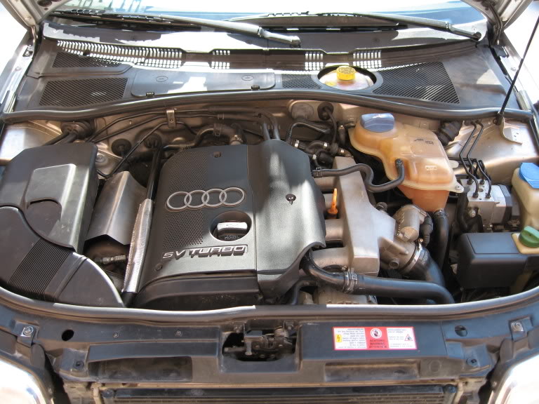

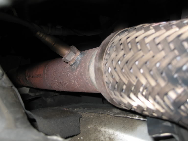

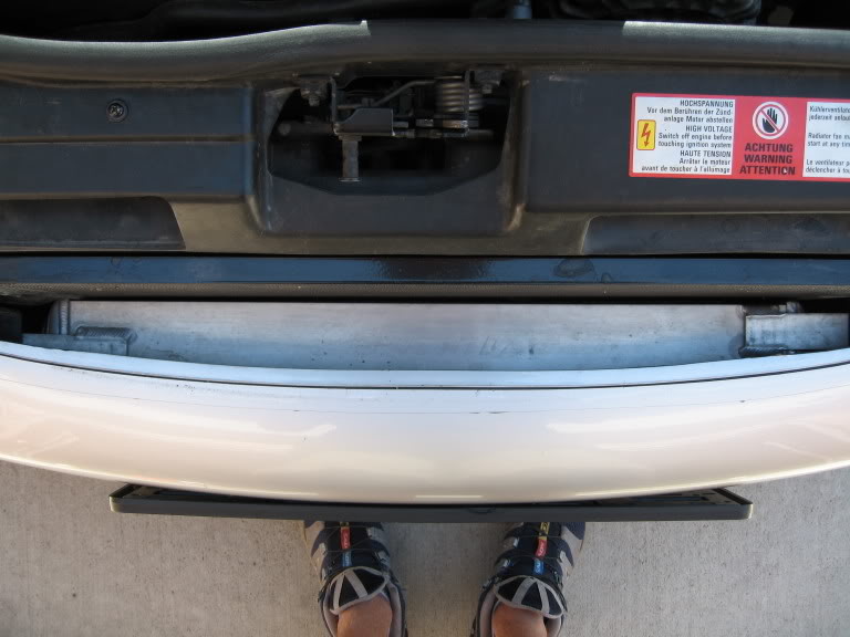

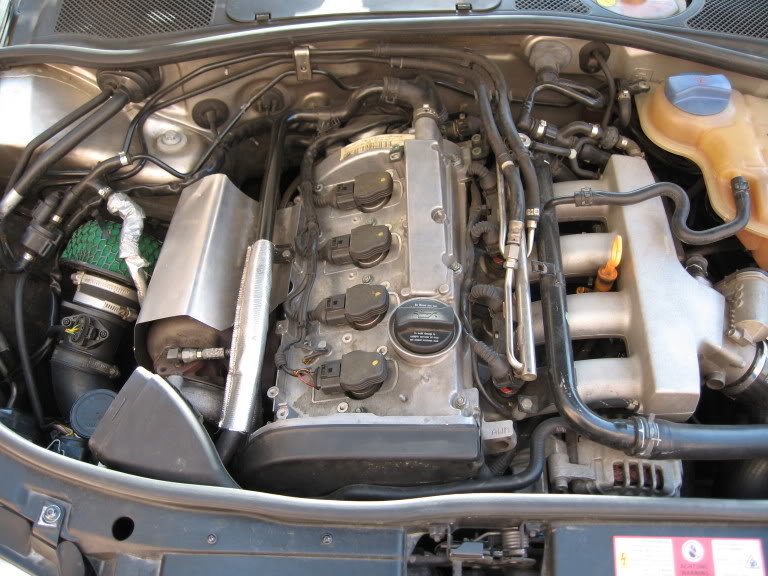

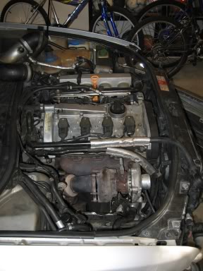

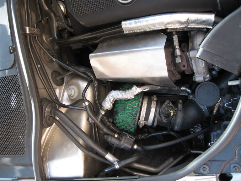

here are a few pics of my t3t4. 550cc injectors, i ran mika but it was heavily modified with lemiwicks sp?.

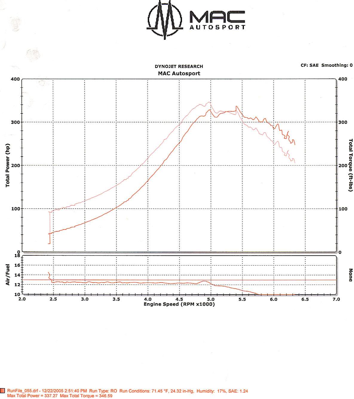

337whp with a messed up tune.
o ya here is a pic of my dp, it was custom made along with the exhaust
