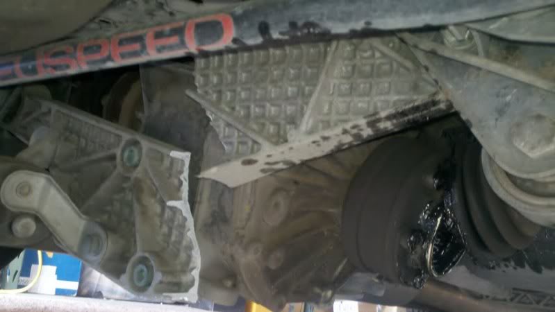

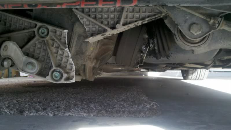

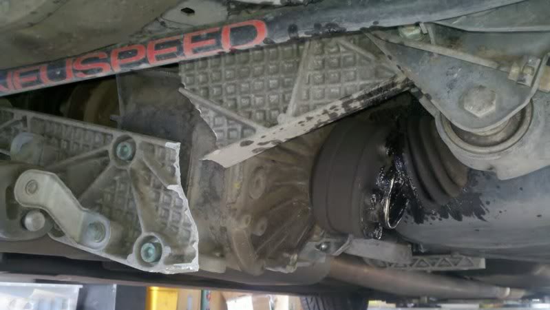

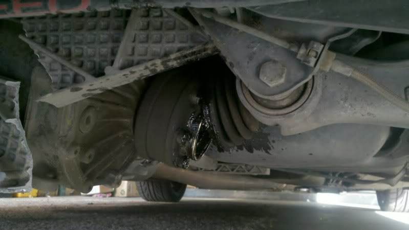

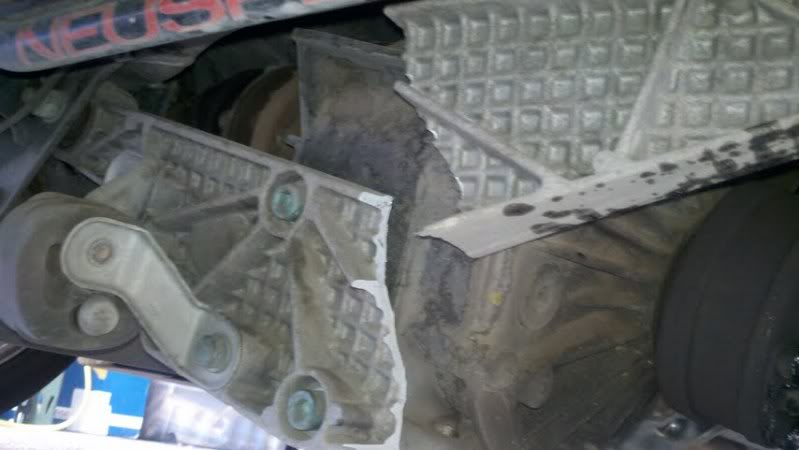

I was sputtering above 15lbs of boost only to remember that I did not re-gap my plugs from .040 out of the box. So after gaping to .030 and doing a 4500 rpm launch the car responded great and boosted to 22lbs. So great that I decided to do another at 6k with the following results ......
UPDATED CARNAGE ON POST #18

So is this a picture of your rear differential broken in half?
Old Mar 5, 2011 | 08:44 PM
fred2ka4's Avatar
Joined: Jan 2007
Posts: 520
From: New Mexico
No, it's just the rear diff cross member and a broken CV axle.
