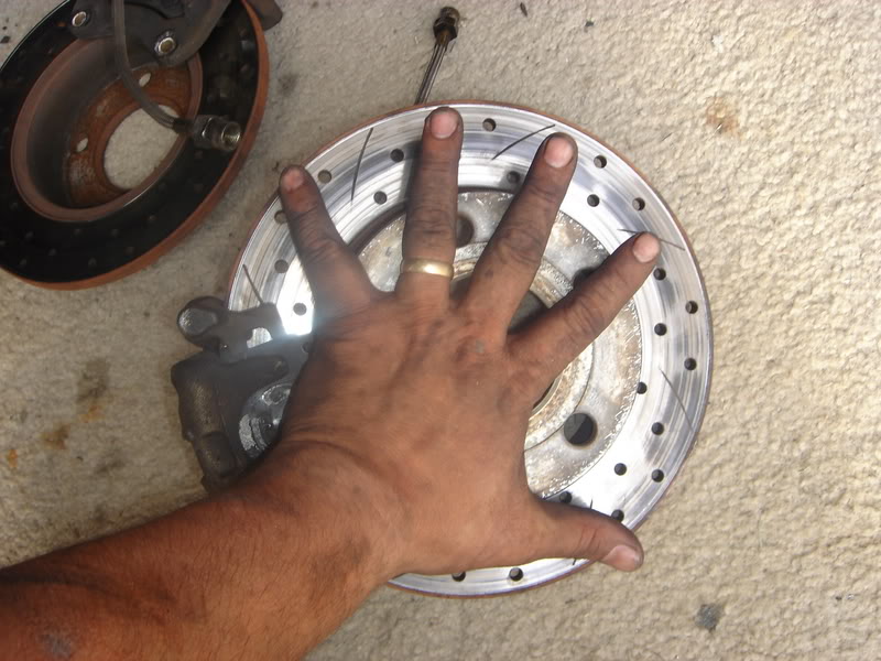

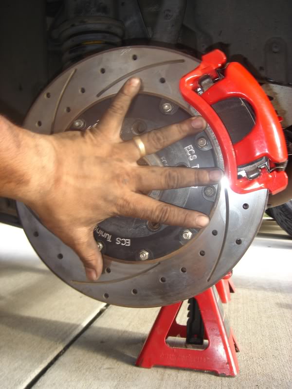

Here are a few pics if you are interested and can source the parts cheaply.
Here are the parts:

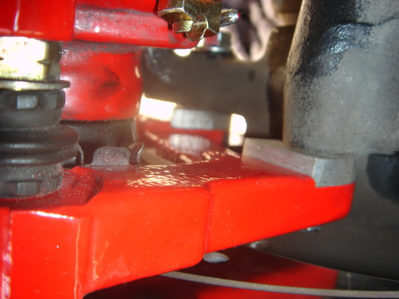

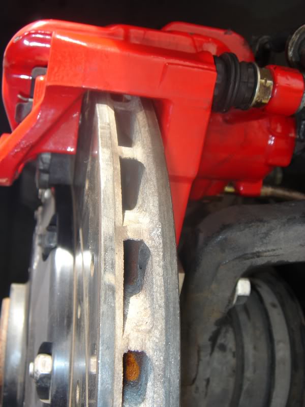

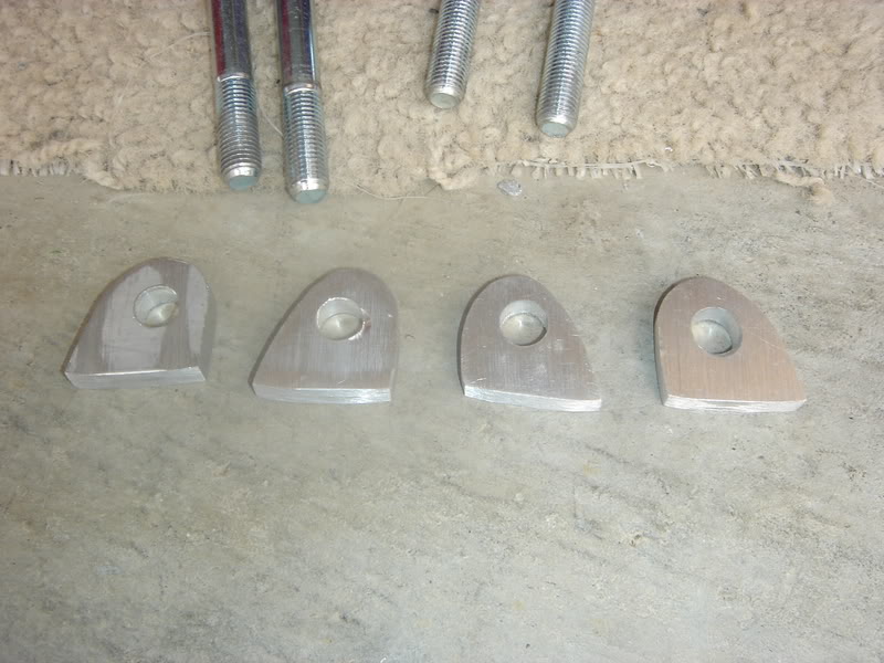

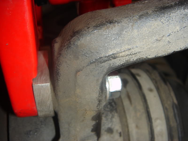

Custom milled spacers I had made:

What they replaced:

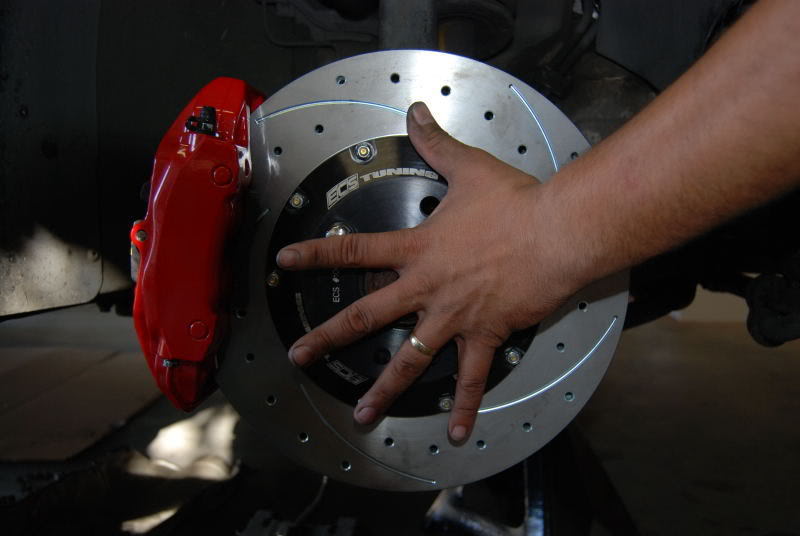

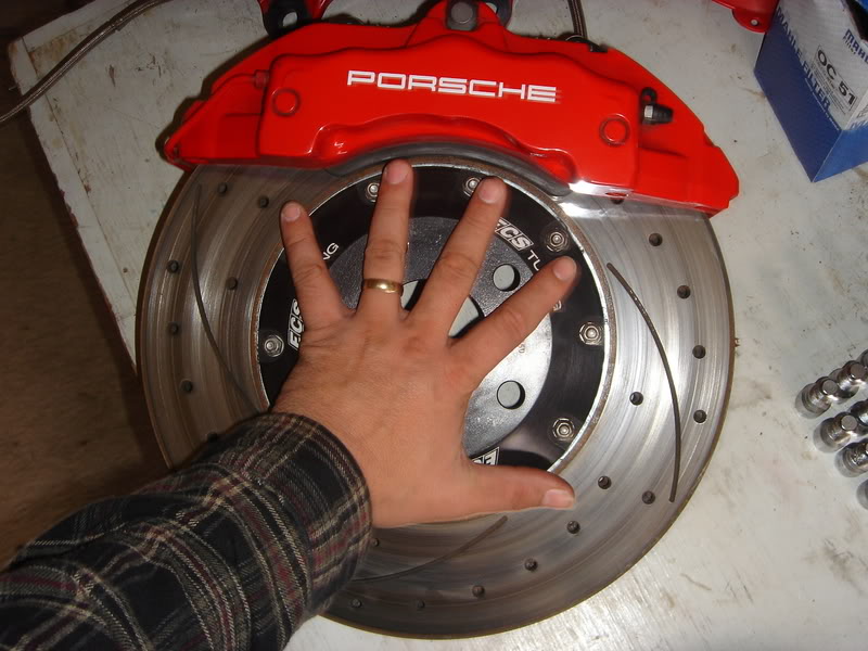

Just for comparison, this is what went on the front:

I did notice a difference in both stopping distance and brake fade, but it was slight. Is it enough of a difference to justify the cost ...... No. If you want a good setup at a low cost I would recommend ss lines all around and upgraded pads.
I already had a stage 2 version 1 setup from ECS Tuning and upgraded to a stage 2 version 2 and then added 911 calipers and custom brackets. At the same time I did the S4 rears but I did not notice any difference in the front to rear bias. The car stops on a dime and the brake feel is excellent.

Here is what I almost had on the front:
