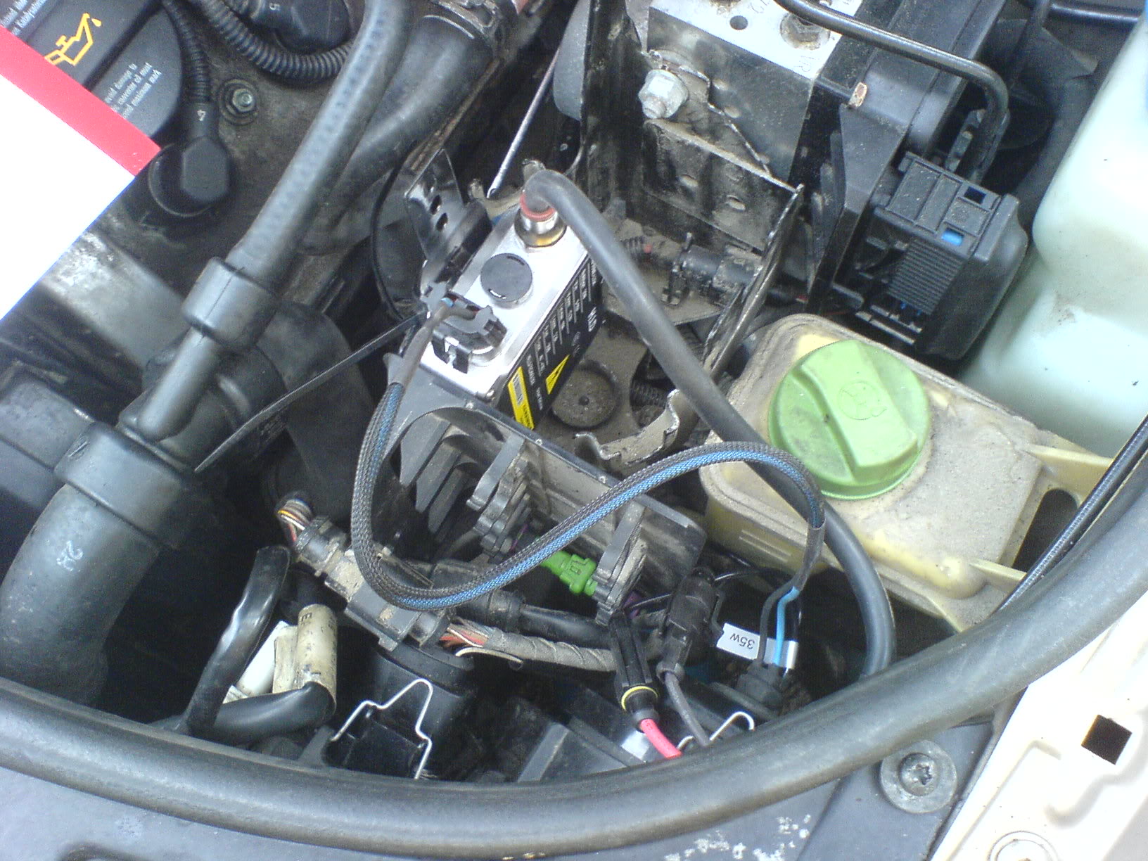

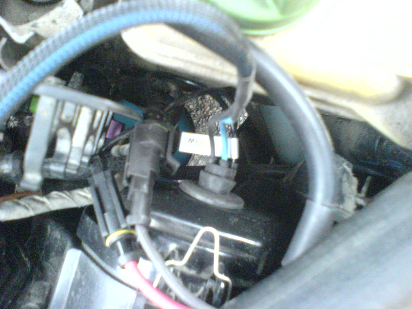

i have a custom CAI so i put the passenger side where the hole for the air box used to be. the driver's side i put it in the thing pimp is talking bout. i had to drill holes for the wires from bulb to ballast though
driver's:

grometted hole

Old May 15, 2008 | 12:34 AM
