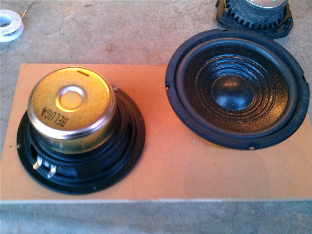

The speakers were slightly more trouble, but not much. The rear deck subs were easy, I just pulled the old ones, and put the frame on the new ones, wired the voice coils in parallel to get 2 ohms, and took the connector off of the old subs and reinstalled them.

New door woofer vs old 4"er

New subs going in.
