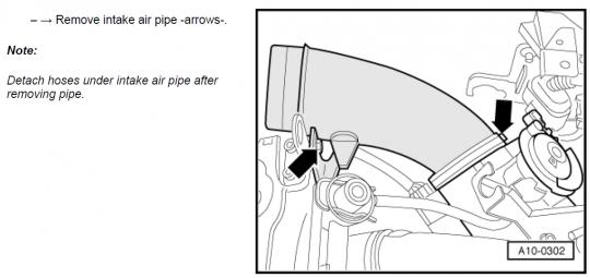

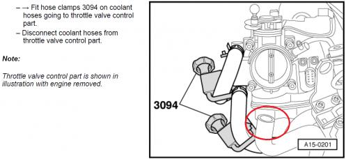

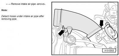

I'll take some more detailed photos and post them soon. In the meantime we've found this, but it doesn't really help as it's basically what we already did.
Supposedly you just need to remove the hose clamp, the bolt holding the black pipe in, and the hoses below the throttle body. We got as far as removing the bolt and hose clamp but just didn't want to come off!
Like I say you have to take that black pipe off in order to go to the allen bolts that remove the throttle body. It's so frustrating, all the other pictures I've seen of others doing other B5 A4's have the throttle body right at the front and really easy to get to where mine is buried under so many other things you need to remove first
