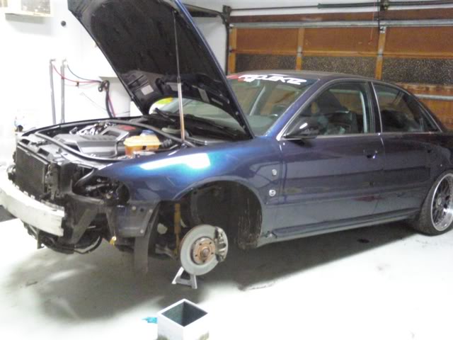

removed front bumper and sideskirts

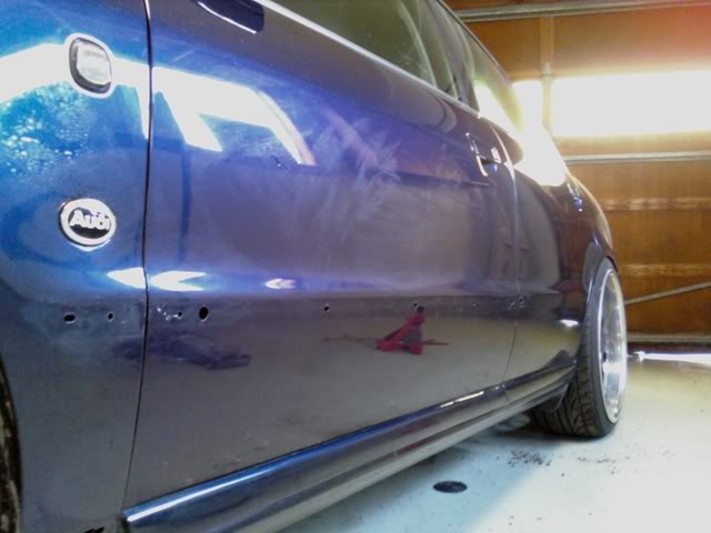

pulled door trim off this morning

that will look sick when its done! how are u planning to plug those holes from the door trim?
Old Feb 2, 2009 | 06:06 PM
a4_2.8tuner's Avatar
Site Moderator
Joined: Jul 2005
Posts: 488
i'm not sure yet which method i'm going to use. i could either weld the holes up or you a special body tape on the backside with filler. both are proven methods, so i'm not sure which way i'm gonna attack it yet.

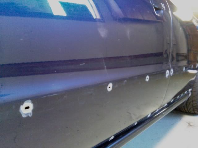

removed the lower trim and grinded down the pegs

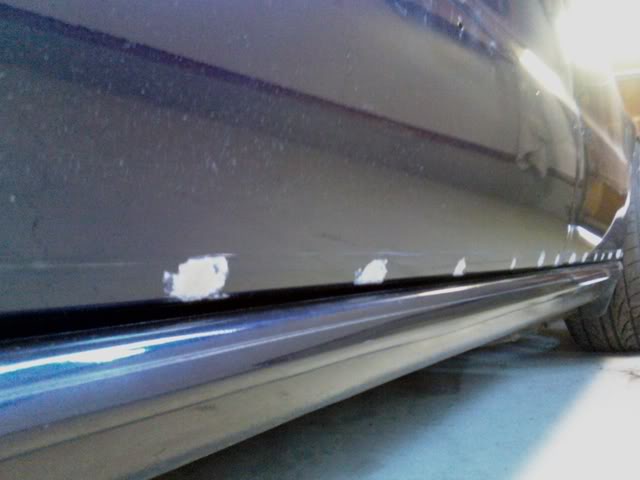

then sanded around the trim holes to get ready for welding on saturday
began sanding the doors
tonight i'm gonna do some more sanding, as well as probably begin laying some filler on the bottoms of the doors to smooth out where the pegs used to be
