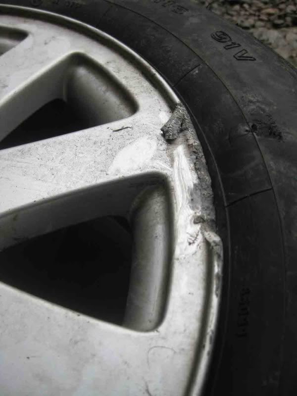

Well I went and whacked the rear p/s wheel off a kerb sideways which bent the rear arm and the wheel is now sitting 25+ mm back towards the rear of the arch. Totally gutted that I done this after faultless driving for over 25 yrs.
Now the car's on the lift, axle removed ready for a replacement. Everywhere is closed over christmas so the agony is prolonged. Then the wife came home with a cracked windscreen in her car. Here's hoping 2012 will be kinder

it's fwd (thank goodness) got a second hand axle beam from breakers yard, getting it sorted tomorrow. If I had have had the RS6's on, the rim would have buckled and probably caused less damage. Them OEM audi rims are made of strong stuff.

OP: reason why I asked if it is FWD is because I did something pretty similar to my FWD. I also stuffed the passenger front corner into the curb (as well as shifting the rear axle beam).
Anyways, I too had to get a junkyard rear axle beam. More than likely it would be a good idea to replace the guide bushings for the axle beam before installing it. The used axle beam I got had guide bushings in pretty bad shape.

It's not an axle in the traditional sense, more like a torsion beam axle (it twists with suspension movement).
If worse damage were done than just a bent axle beam, the chassis would be damaged. Fortunately the axle beam mounting brackets have oval-shaped holes, so the axle beam can be repositioned to the ideal position. These oval-shaped holes are what allow the axle beam to be aligned.

thats it sorted, wasn't too difficult to get it re-fitted, brake lines hooked up again and bled.
