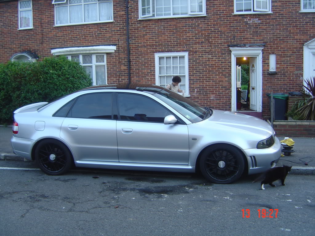

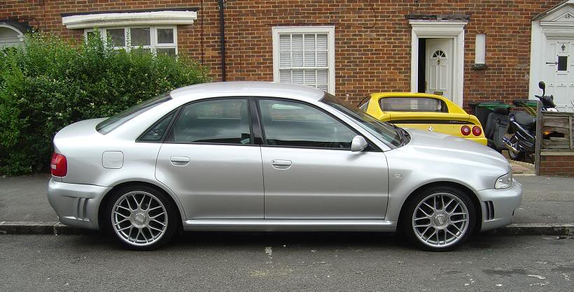

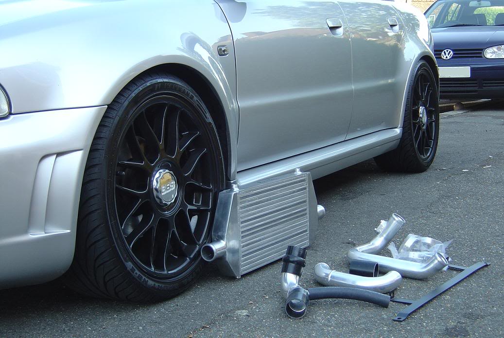

docurley Jun 10, 2009 09:04 AM
3 Attachment(s)
This is standard Audi sport setup.
http://i6.photobucket.com/albums/y22...y/DSC01155.jpg
Attachment 44377
And here again with H&R race springs
Attachment 44378
Attachment 44379
