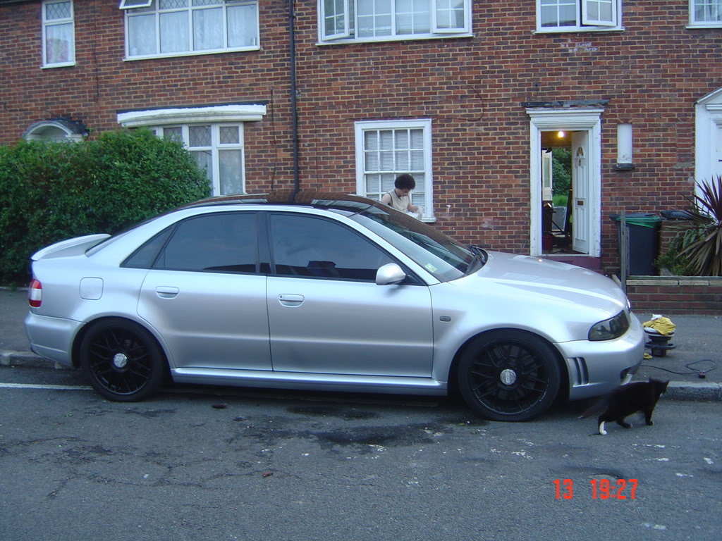

This is standard Audi sport setup.
And here again with H&R race springs
