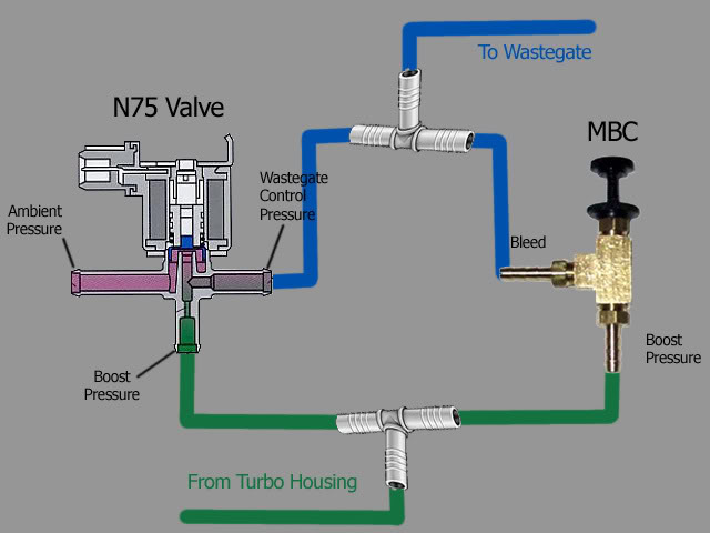

so first off does anyone have the diagram for the 3 prong boost controller using the N75 valve??? but i got really bored with the 14 psi i was getting with the k04 flash. so i put the MBC on i had laying around in....yeah its sweet spikes at 22 psi holds at like 20 psi( only in 4th gear..which is also weird) but also if im not getting on it(more then 1/4throttle) the turbo will boost at im geussing the 20 psi but its blowing off and dropping to 10 psi until i get on it some more ( i have the race N75 still connected but not doing anything) is this the problem with using only the MBC.. am i going to blow something up!?

https://www.audiforums.com/m_583205/tm.htm

read post 23 and 24........... i have no clue as to the boost build up......... i know with my car since i have done the stuff i have lately...... and running the forge 004
if i give it more than half throttle..... it blows off alot........ so i just go half throttle....... and let the boost die off
