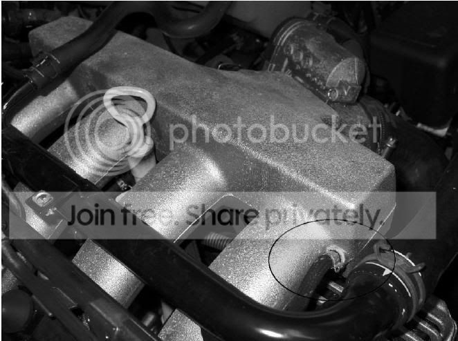

hi all got a boost gauge for my 1995 a4 turbo and i am unsure which vacum pipe etc to connect to i got a t piece etc to fit it to any ideas or diagrams even any help much appreciated cheers kev

t into the line that runs into the intake manifold

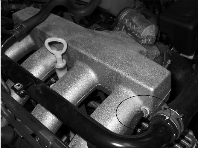

Here
Or at the FPR vac line.

thats great thanks for all your help guys
