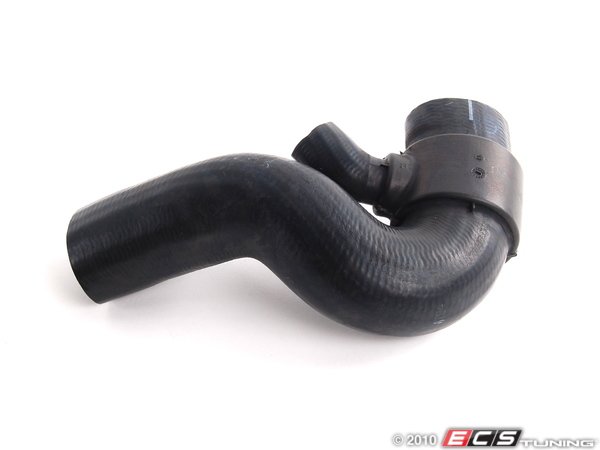

Hooked the leak tester back up this morning and started crawling under and over everything. I found the hose coming from the turbo down to the cross tube to the intercooler was split.
The dealer wanted $197 and Oreilly wanted $155. I figured I would try to patch it with epoxy and silicon tape. Everything seems to be holding for now. Hopefully it holds for a few more weeks until I can get this thing sold.

$155?! Do you have a picture of it by any chance? If not, get one and we'll look together for an inexpensive alternative.
If you're bold enough, there should be white writing on it.. that'll show the part number.

We have aftermarket ones available for $119.95
Click HERE to order or for more information
