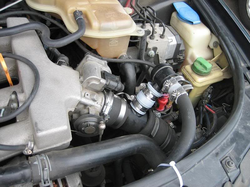

Keep the closed loop system, but put the dv where ever you want.

why? performance is the same, only thing different is the install and sound
