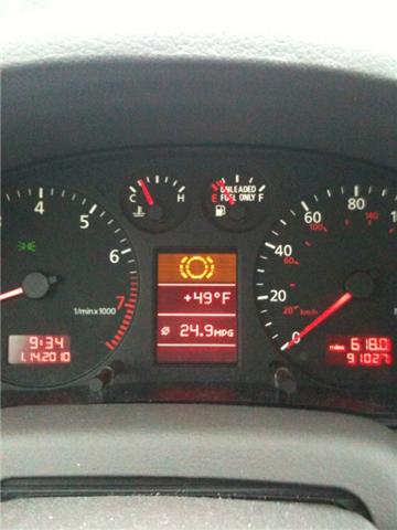

My son in laws 2001 A4 Avant has this warning light on. The symbols in the manual don't exactly match up. Bentlys does not show the warning light symbol either. Looks like it could be an ABS problem or Electronic differential lock or???
Any ideas ?

front breaks are worn. pads are down to the senor. might be time to replace

you have a brake light out

We pulled the RF caliper apart and found the pad wear sensor wire parted at the pad. I spliced the wires together and road tested the car, no light.
