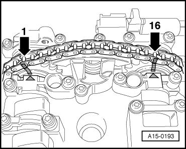

i believe there is a TDC mark on the camshaft sprocket and backing shield - there are also notches in the camshaft ends near the chain which should be at 12 o'clock and like cca4 said - 16 links between the cams
