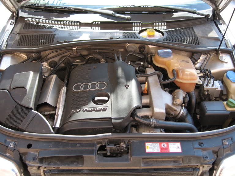

is this visual inspection some guy looking under your hood? do they know what the stock turbo looks like?
here's a t3t4 that looks almost stock (Jeff's old a4)

dam chaos that is pretty undercover! Auditech79, what do you think? Is Jeff a CA guy? Some smog techs might be smarter than others I guess? I have hope again!

yes the visual inspection is a guy looking under the hood, usually for the cat.
