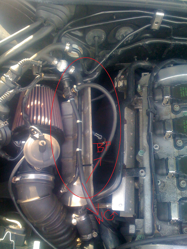

Car is tip, i have my MBC lines on my heatshield and the smell is right in that area, if u look directly at my cat and smell its really strong. and i mean 12psi by im on stock ECU with my mbc set to 4 psi higher than stock. the jerking was only when my engine was cold, when it got to normal temperature, it ran normal, i lowered my psi to around 9 and seems to run fine cold. i am going to order my chip sometime this month. heres some pictures of how my mbc is hooked up.
WG= Waste Gate BP= Boost Preasure. its hooked up right just i used long lines so i can have access to it

The black part in the red square was covered in condensation and there was a hissing noise from the blue valves
should i shorten my lines? will my car run better if i do?

That hose that runs between your cat/turbo and the airbox heat shield could be the problem. Also, that is a heat sink on the bottom of your ICM. It should be bolted to metal like it was on the stock air box to disipate heat correctly.

lots of people don't have the icm attatched to anything and don't have problems.... or maybe they do. I don't think you need to shorten your lines, just move the mbc to the other side of your intake.
