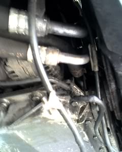

This seems to be the more common pipe that ends up cracking based on what my brothers friend told me that works at beiner audi.
If you have the car on the lift and are facing the front. When looking up you'll see two pipes. One of those pipes further up was what cracked on me.
It's not a simple thing to replace IMO, unless someone else knows how to. They do sell them on eBay but im not sure which one this is.

maybe thats why your a/c isnt cold enough.
You should check that same pipe i posted the pic of ^ up there.
Theres a piece of metal right in front of the pipe which gives it like a half inch clearance. I gotta find a piece of rubber or something to put inbetween it.
