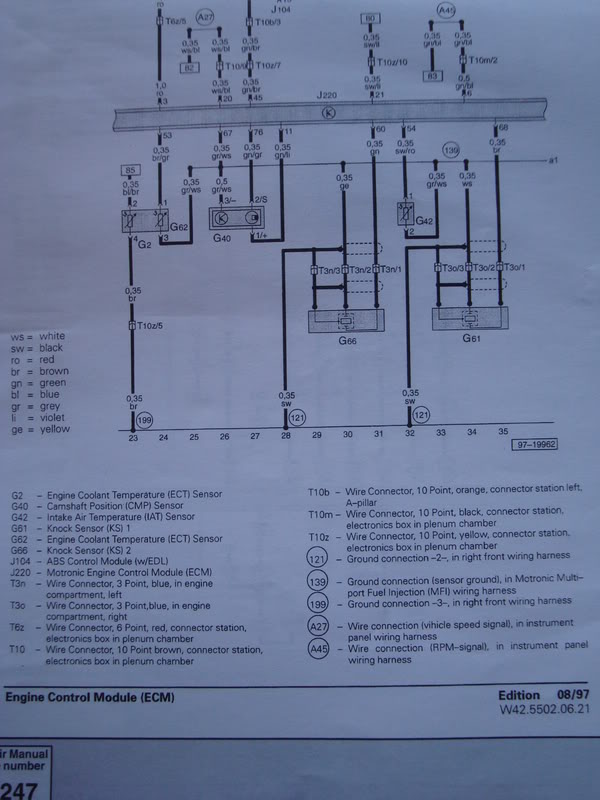

Can you read this Diagram?
Old Jun 8, 2008 | 07:50 PM
primo537's Avatar
Joined: Dec 2005
Posts: 107
Default Can you read this Diagram?
Im trying to figure out if i can ground 2 of the wires comming out of the ECT(g2 in the diagram) to a bolt (or something) thats outside the ECM.
Correct me if im wrong, but the ECT has 4 terminals:
terminal 1 - to ECM
terminal 2 - to instrument Cluster
terminal 3 - to ground
terminal 4 - to ground
