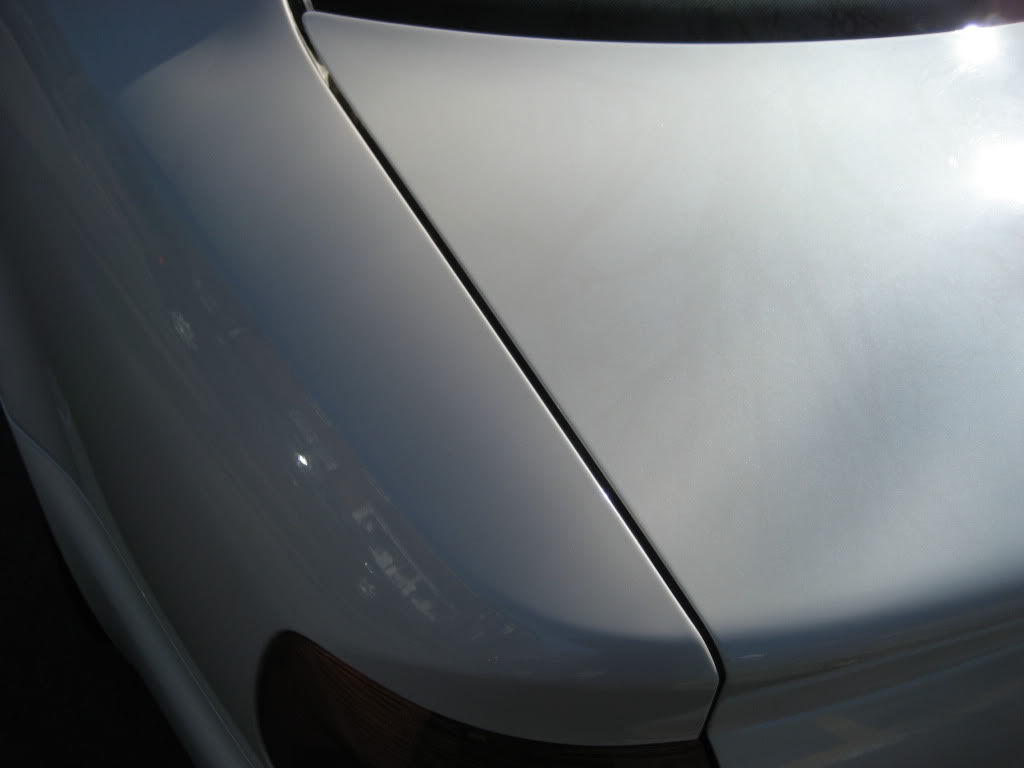

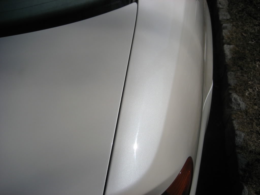

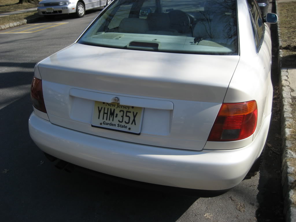

So as many of you may know, I recently had my trunk lid bashed in by a wayward snowplow. I finally got the car in for the paint and picked it up Wednesday of last week. I knew it was going to be difficult for the shop to blend the new pearl paint with the old, but I believe they pulled it off. I have to realign the trunk lid a little better, but all in all I am satisfied with the result:

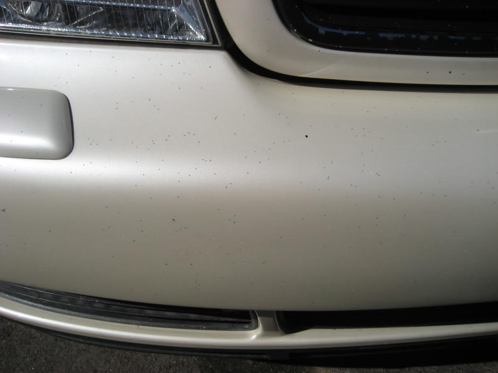

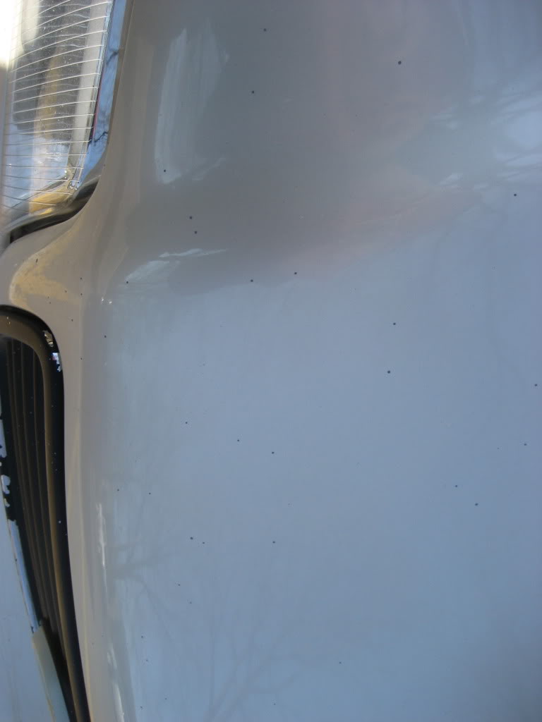

Well, fast-forward to this past Saturday, the first really nice weekend the North-East has had in a while. I decide to give the old girl a wash and I notice this abortion on my hood and front bumper:

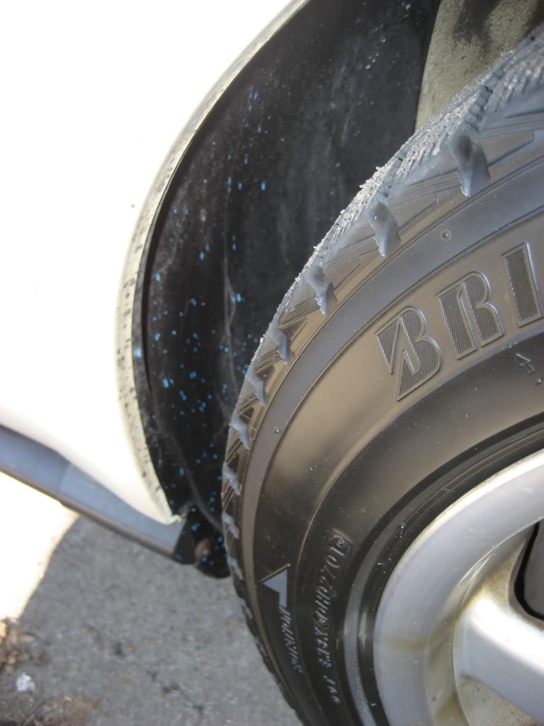

And in my wheel well:
Yup that is sliver/grey paint that freckles the entire front of my car. Keep in mind the only clean part of my car when I picked it up was from the rear passenger doors back. The front was still dirty as hell . The shop was nice enough to give me a voucher for a car wash from a local place .

those aren't rock chips they are over spray

yeah i know you know Andrew said they were but yeah when i worked at a body shop that happen twice from when people didn't cover up the cars you should be able to go back and they will either buff it off clay bar or have to repaint the car i hope they don't try to make you pay for it it was their fault so don't back down but they did do a really good blending

Fortunately a simply claying and polishing should take care of this. So it's most likely not the end of the world if they don't own up to it.
