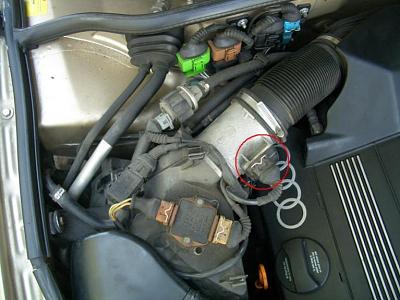

I had jerking while accelerating and it was the air mass flow sensor... you can try to unplug it. This will make the CEL go on but while it is disconnected, you can drive it and see if it improves anything. (beware of the much lower MPGs)
Mine didn't jerk at all after I unplugged it and I've already ordered a new one.
Remember, you will have a CEL that you will need to reset, if you try this. It could be something else, this is just a cheap and simple idea.
Unplugging the mass air flow sensor could cover up a symptom from a different problem source related to fuel/air/ignition. If you don't have a lean/rich related maf fault, there is really no reason to consider it. I think even autozone's fancy scanners can give output readings for the maf.
