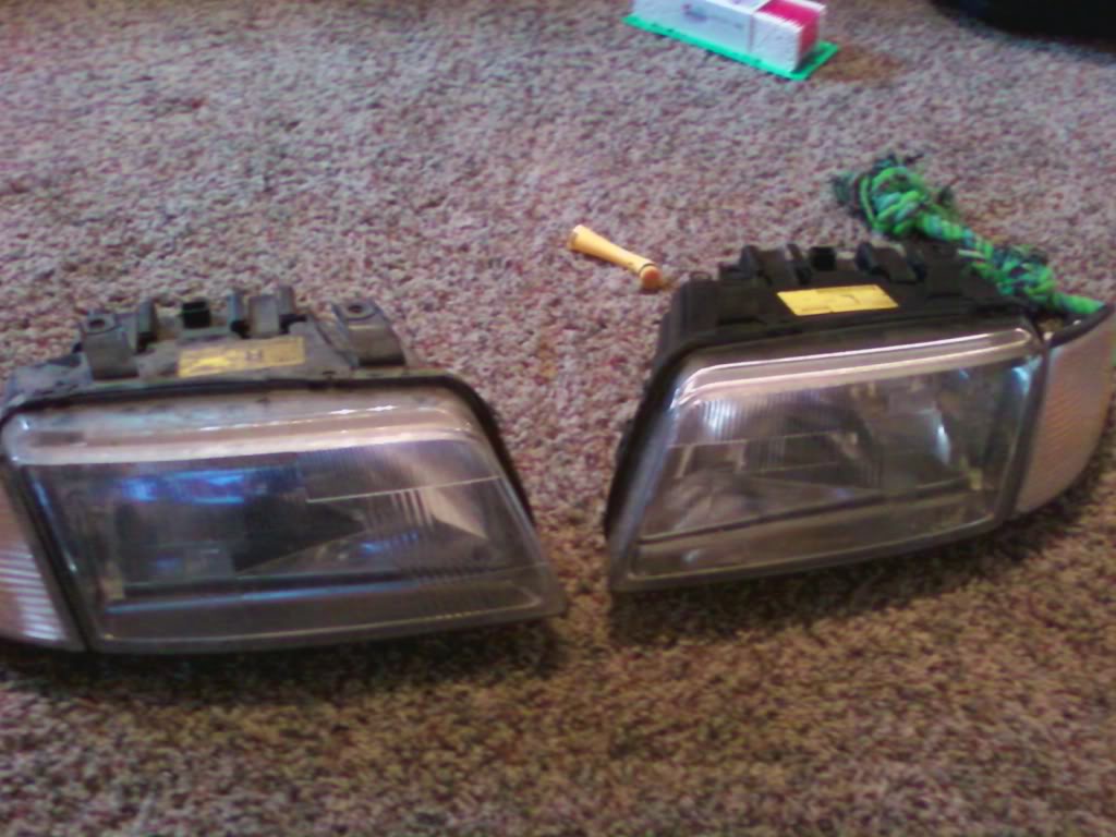

lol I get to eat my words now. Finally found a buyer for my Sonar's! Unfortunately I also found that A/C compressors are expensive, and I need a new fan clutch as well. Sooo... back to those stock headlights I have in the basement...
They shine up nice! I've thoroughly cleaned and polished the right, haven't started on the left. For 90k on them, they dont look bad! Well... okay they look BAD, but i mean they look good for old 97 headlights.

try to take those headlights apart and clean the inside of them than reseal them up my friend clearcoated his headlights and they look brand new

Actually UV damage in on the outside (yellowing, cloudiness) and can be removed by fine grit wet sanding and then polishing. If you clearcoat them after that, make sure that it specifies that it has a UV protectant. If you don't, it won't stay clear for very long.

I'm not all that interested in doing so much work on these lights. They'll only be on the car a maximum of 4 months.

a4 2000 i have never done it myself i did buy the kit that has all the sand paper so you can do what your talking about
