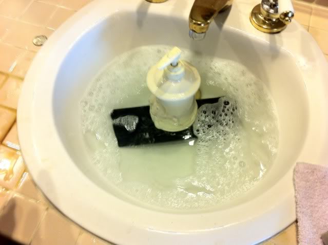

I would like to show an effective and easy method to clean your sticky buttons on your Climate Controller (this also includes the radio buttons). If you are able to search and find the directions on removing the climate controller, then +1 to you, I am not going to make an essay out of this.
Unfortunately I forgot some specific details, but I do remember some screws holding the assembly together on the back side, so you can seperate the electronics from the buttons on the front.
Ultimately, you will need to soak the buttons in soap, and possibly spray with simple green to loosen up the soda stuck within.
I did this with my previously owned '01 A4, and worked like a charm, no need to purchase another climate controller, and lets face it, if I got another climate controller, it would be sticky too. Its that damn dash cup holder causing all the problems.
OH!!!!!!! Make sure you let it dry out before installing.
Attachment 30096
Attachment 30097
Attachment 30098

Good idea! I just used a paper towel sprayed with fantastik but i feel like your method would be more thorough.

I have come across numerous A4's that I have purchased that have this problem. Some worse than others. My most recent A4's climate controller was really bad, so I really had to disassemble it to do a good job.
