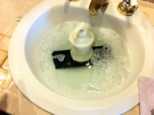

I would like to show an effective and easy method to clean your sticky buttons on your Climate Controller (this also includes the radio buttons). If you are able to search and find the directions on removing the climate controller, then +1 to you, I am not going to make an essay out of this.
Unfortunately I forgot some specific details, but I do remember some screws holding the assembly together on the back side, so you can seperate the electronics from the buttons on the front.
Ultimately, you will need to soak the buttons in soap, and possibly spray with simple green to loosen up the soda stuck within.
I did this with my previously owned '01 A4, and worked like a charm, no need to purchase another climate controller, and lets face it, if I got another climate controller, it would be sticky too. Its that damn dash cup holder causing all the problems.
OH!!!!!!! Make sure you let it dry out before installing.
