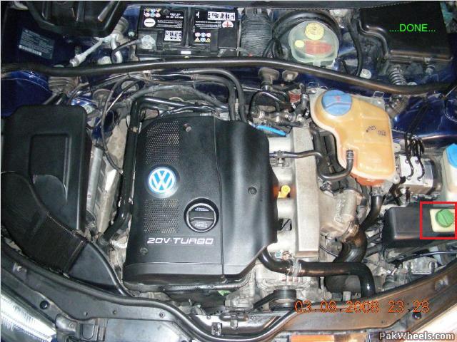

this tank says like Hydraulic somthing on the cap.. my steering feels fine.. my car shifts fine. coolant level seems ok. brakes work. so i seriously am stumped. my dad diped a rag in all my tanks to try an match colors and the square'd tank is the only one that came close to a match not my car but it works....
Attached Thumbnails Coolant Leak....... :(-engine.jpg

That's the power steering reservoir. It has a greenish look to it, commonly mistaken for coolant by drivers used to seeing green Prestone anti-freeze.
Audi PS uses Pentosin. DO NOT TOP WITH RED OR AMBER PS FLUID! Start inspecting the lines, pump, and rack for leaks.
