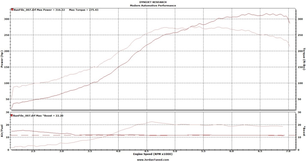

I am confused by your dyno. Typically once you have boost onset it comes on fast and hard but it looks like yours is more linear which is not necessarily bad just different. I am really not excited by the GT2871 response on the 1.8t at all. 20 psi by 4500 is similar to what I have seen on B18's with T3T4 turbos. I have actually seen TD05H big 16G out spool a GT2871R and is one of my reasons for seriously contemplating the billet 20G. Your AFR's are closer to 11.0:1 which is OK but still not ideal. You have maestro why not try to tune it yourself? From what I have heard it seems to be fairly user friendly.

His AFR is exactly where it should be for a 1.8t which is right around 11.5:1. Running it leaner then that doesn't make more power it just increases the EGT's.

As for EGT's and ideal AFR's I have always been under the impression that 11's are overkill and around 12 is best. I am sure this changes which each motors DNA but the majority of Dyno's I have looked at show target AFR to be in the 11.5-12'ish range. Some EGT is good for spool which it looks like he could use a bit of but I think I saw where he is using 2.25" exhaust and am wondering if that is why his spool is slower.
