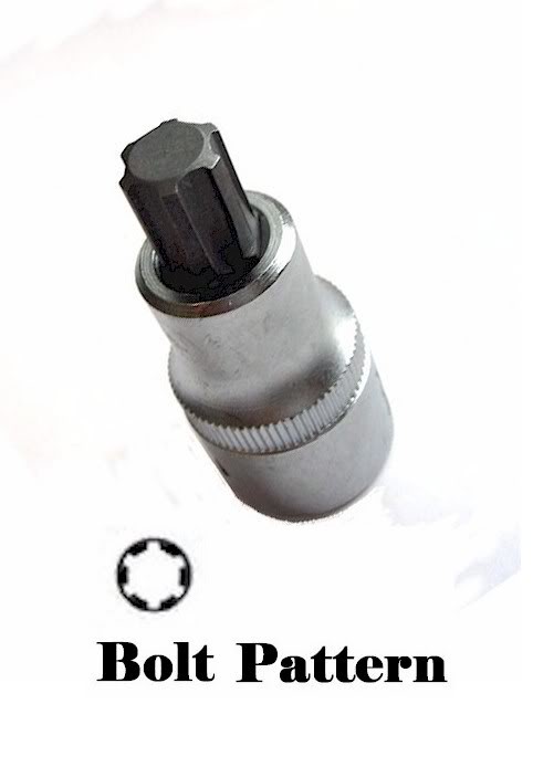

Hi, I have a 96 a4 quattro that we're doing an head gasket replacement on and was wondering if anyone out there know what size torque spit to use on the cylinder head bolts? Is it an Audi specific tool that i need?
55 is too big and 50 is too small.
These are the bolts I got from AutohausAZ:
VictorReinz
Cylinder Head Bolt; 137.5mm Length; 6 Point Head
Any help would be appreciated.

do the bolts look like this?
if so then its called a polydrive headbolt tool. its not a regular torx or tripple square bit. you can normaly find them on ebay for like $10 or i think ecstuning.com sells them.

http://cgi.ebay.com/ebaymotors/VW-AU...motiveQ5fTools
That is the tool you want. might find it cheaper elsewhere
