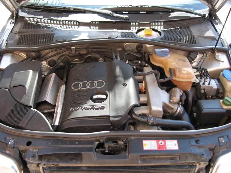

I can tell you from personal experience that the Eliminator (both the GTRS and 71R) make more power on the B6 chassis than the Full GT28RS and the full 28-71R. I have proven it with my car and we have duplicated these results on three other cars that I was involved with.
It may look cool to some people to open your hood and see a big (not quite big ***) turbo hanging off the side of the block (see pic)
But I prefer the stealthiness of the Eliminator setup
There is nothing better than going to the track and opening you hood after a 12 second pass...all of the import guys will rush over to see what you have, at that point I just tell them it is stock.

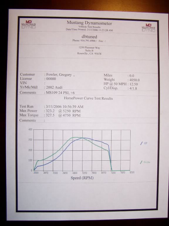

Here ismy 71R Eliminator Dyno Sheet

Nice numbers well done! Gives us all hope for more power from the elim turbos.
