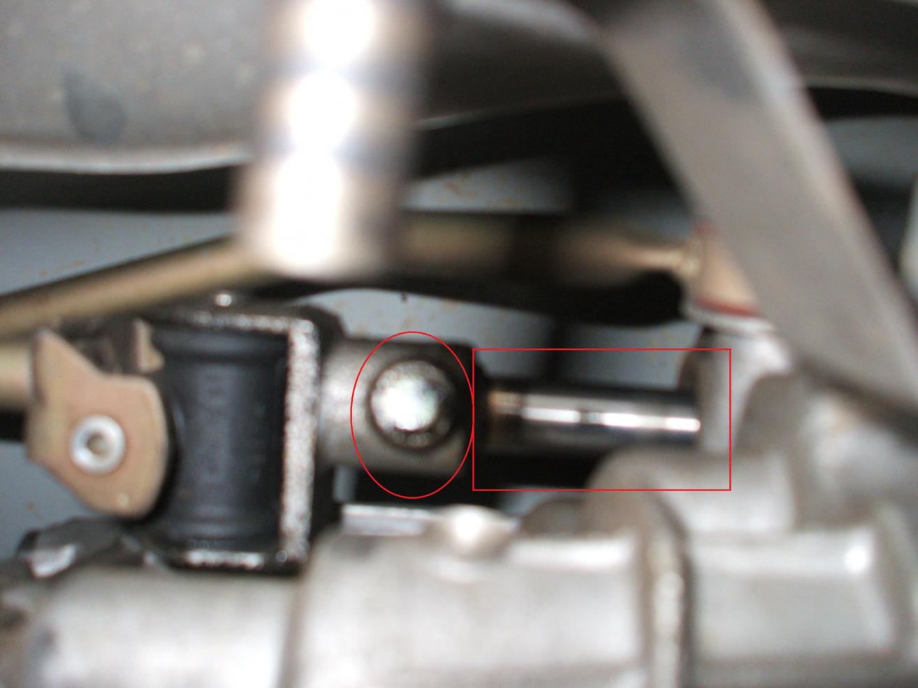

There is a shaft here that only has a single bolt going to it.
A) Is this the shift rod?
B) Do I just take the bolt out and pull the shaft out?
Yes you loosen that 10mm bolt and pull the shifter linkage off the transmission arm.
There is also a shifter support arm that bolts to the transmission. It is the other arm that is next to the shifter linkage arm. It bolts to the transmission with a 6mm allen head bolt. Need to cut down the short end of a allen head tool to loosen it.
