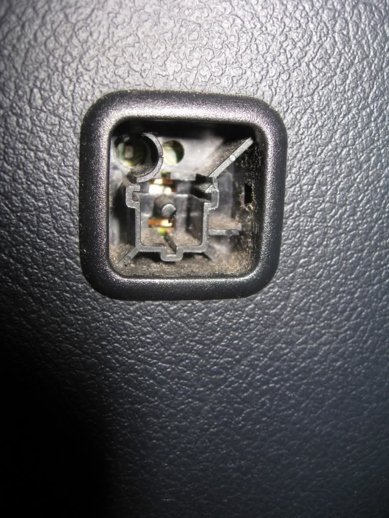

when I look where described... it sort of looks like the button has been removed. Is this how it is supposed to look? I DID leave my windows open, but i usually do and it never did this before. I am still not ruling out the possibility of the motion detector.

Do the flashers come on when the windows are closed? The button is missing but you still might be able to turn it off by pushing the center piece in that space.

This happens to me all the time... If I leave the windows down and it's windy, and the motion sensor for the alarm is on, and the car is locked and alarm set, then wind will trigger the sensor and the lights will flash and alarm will sound.
That missing button is the motion sensor button... You need to either turn the sensor off or just lock your doors but do not engage the alarm (ie. do not lock it with the remote, lock it using the button in the door and press it once), if you want to leave your windows down.
