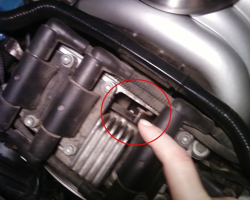

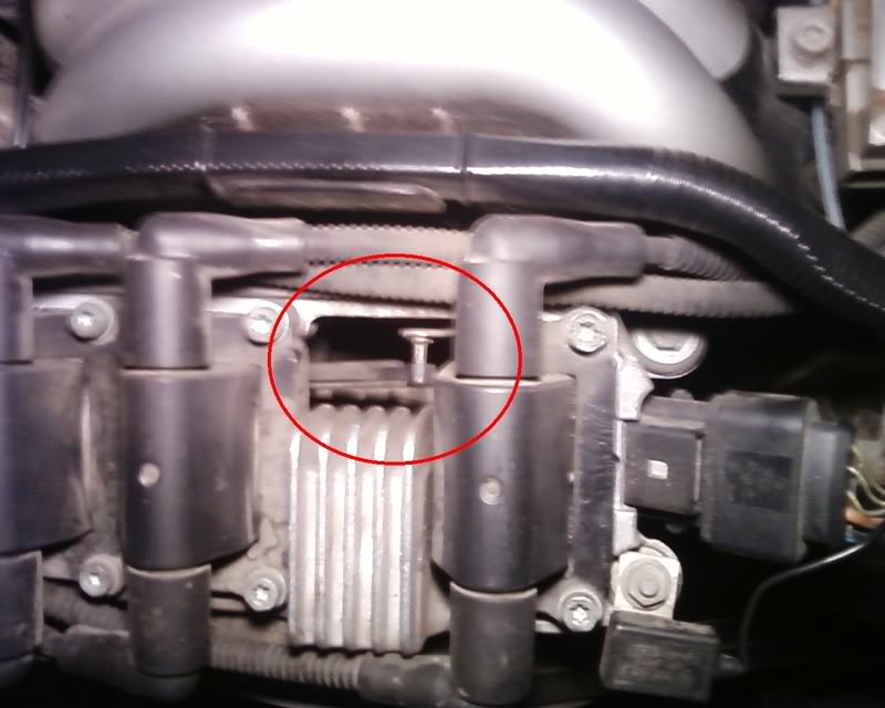

Anyway, a lot of weird noises in our engine can be solved by tapping a couple of times on the thing I've circled in the following pics. Give that a shot and see if it makes a difference in whatever noise you're hearing.
