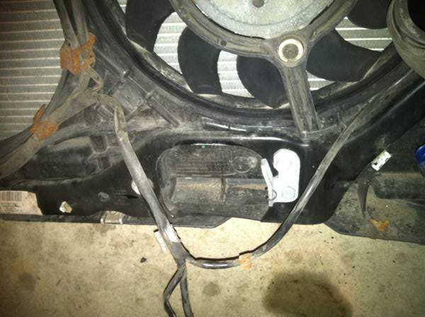

Side note. This is where the snub mount fits when the rad support is installed. Im looking at a few snub mounts from 034 and they all come with a bracket thats shaped like this space, with a bung for the snub mount to fit into. This leads me to believe my car is missing the other half for the snub mount to fit into... the car was a prior salvage but everything seems to have been replaced to OE spec. except this. is there supposed to be a bracket for the snub mount to sit in on the rad support?

did you notice whether there is supposed to be a bracket that the snub mount sits in or not? because looking at my snub mount, and the spot where it fits into the rad support, there has to be 3/4" air gap around the mount and the rad support. but the o34 kit has a bracket that bolts into that spot and the snub mount fits snug into it so theres no free room for it to slop around.

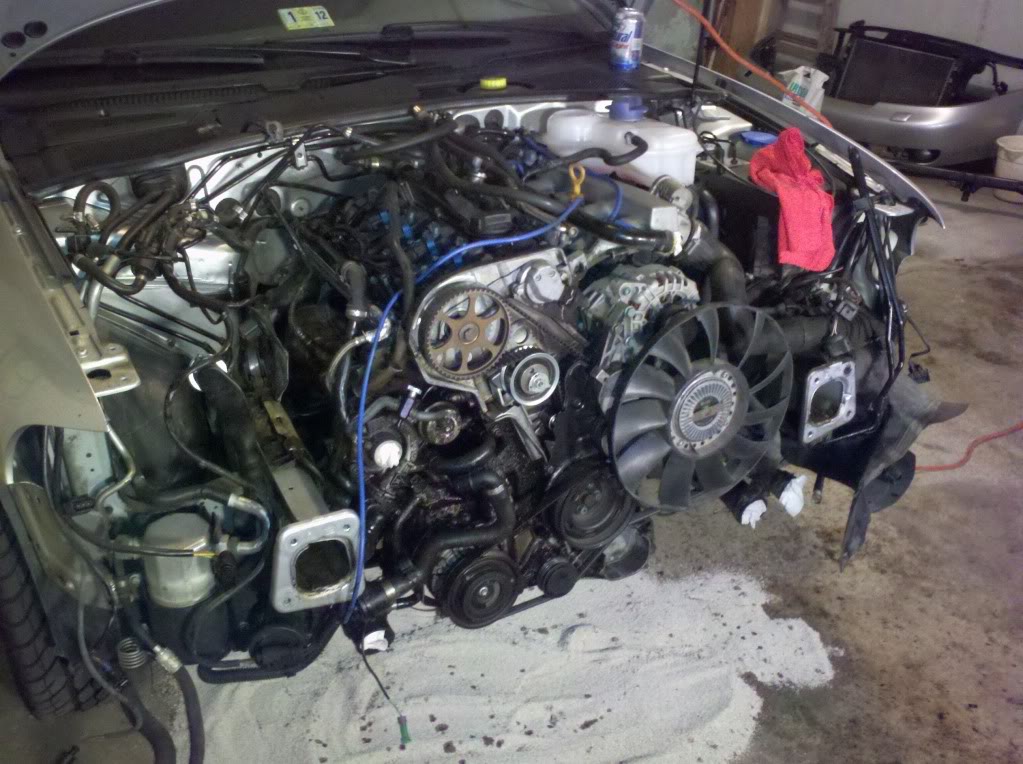

Yea i dont mind a little vibration. I like being able to "feel" the car a little more when im driving it. I just dont miss my *** going numb after driving the rx7 for more than 30 min. lol But the mount bracket from 034 looks like it bolts to the opening on the rad support where the OE snub mount resides. The description on their site was for a b5 2.8 A4, heres the link:
Snub Mount With Bracket, B5 2.8L V6 - 034 MOTORSPORT
Do i spot some Natty Ice in this picture? lol

LOL It's Natty LIGHT. Don't judge me
I see that bracket now, looks like it bolts over top of that gap in the core support in that picture you posted earlier. That should work fine!
