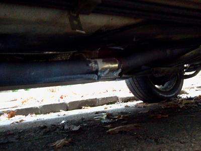

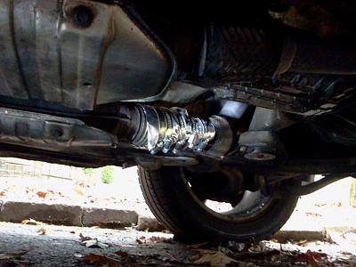

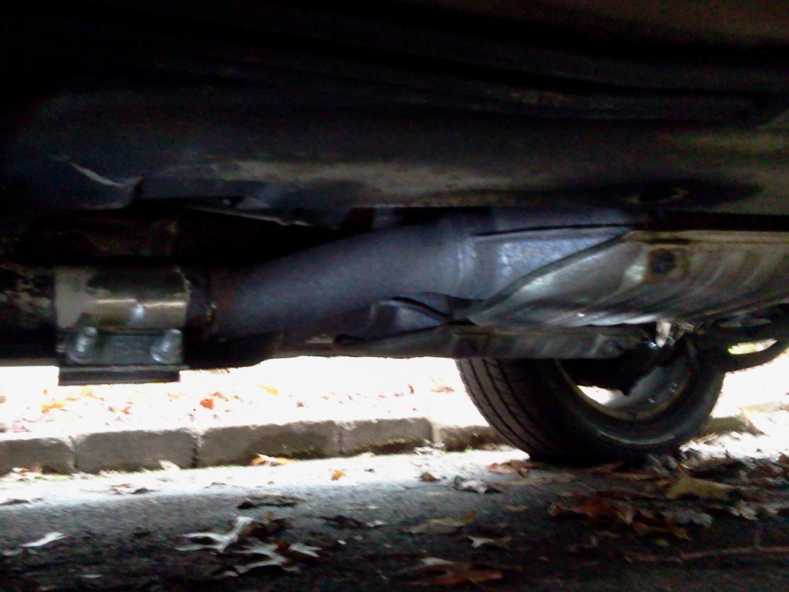

just adding an update. I took some pictures to help better explain the problem. The photos were taken from the passenger side just to give you the right perspective. After doing some research i believe that the passenger side front pipe is okay. The spot that i patched with the clamp appears to be the end of the front pipe anyway (can anyone confirm this). Then the crappy looking patch is on the drivers side front pipe. I believe this pipe will have to be completely replaced. and looking on ebay i have found that pipe for under 200. I feel cheap buying car parts on ebay but the price is right. will this be better money spent then pulling the pipe from a scrap yard?
Thanks for your input

Flex joints are the weak point of the system. Unfortunately, the down pipe, flex joint and cat are all one piece on these cars. When one of my flex joints began leaking, I could tell (visually) that the other wasn't far behind. I took it to a local exhaust shop that cut out and welded in new stainless flex joints for $200.

That patch is really ugly but serves the purpose. Time t replace down pipes or go to Midas or what have you and have them fixed.
Last thing you want is those claps to fail and exhuast to "pole vault" under your car

Blazing to raise a good point about the catapult. The first time the exhaust broke it actually came pretty close to the ground and i never even thought about catching it on something. And ya that new ugly patch was mostly due to that i was out of town at my girlfriends and she doesn't even own a hammer, so i just tried to fix it as cheap as possible to get me home and having to purchase duplicate tools. But seeing how much it was for you bshusted to get the flex joints replaced i this i just order this down pipe off ebay.
