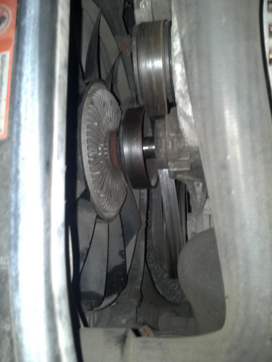

So, I am driving along last night and hear this noise. I stop and pop the hood and it looks like the fan pulley assembly has seperated from the engine block. The clutch and fan blade are intact. However, the pulley is is shot appears and has the hub assembly still attached to it? I've done some searching and can seem to find the part I need. I'm guess I need the assembly for the fan that includes the bearings? any idea what this is called?

Don't know what motor you have, this is my AHA 30V 2.8. When I Google the part# 078121235f they all call it a "fan retainer".

Oh, from your pic it looks like a 1.8. But that gives you a starting point. If it was mine, I'd just hit a local junk yard for it.
