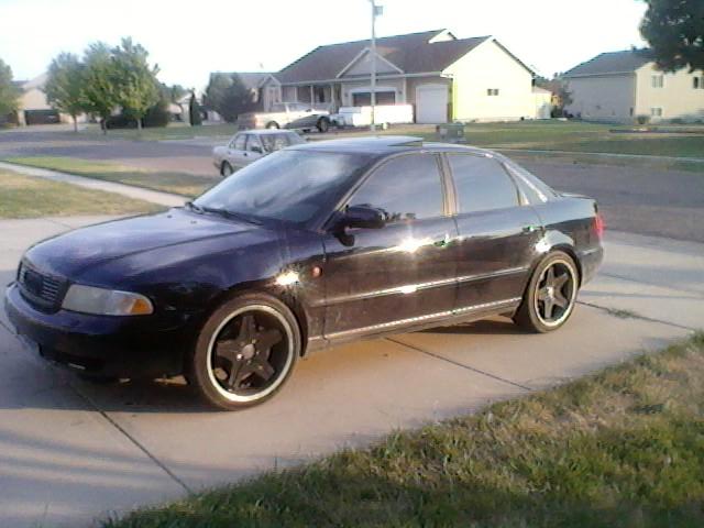

Ok, hi everyone. last year i bought a 1999 audi a4 1.8t quattro. so far its been a money pit. first off its slow. wayyy slower than i think it should be. i had my mechanic here in sioux falls take a look at it. he ended up replacing 2 control arms. tie rod ends. turbo bypass hose or something of that nature. i now work at a mechanic shop and my boss took a look at my car. "he is kind of an idiot." he says that both of my front half shafts are shot. i know i have a torn cv boot on the front drivers side but i dont know how to tell if the whole half shafts are bad. he also tells me both of my cams are shot. he says my shift points need reprogrammed and a bunch of other stuff. if any one can direct me on how to tell if these things are bad. or direct me to someone around the area that would be willing to help work on this car for not Graham automotives price of 140 an hour. that would be awesome. along with any tips and pointers on power improvements. wastegates, test pipes, all of this stuff i have seen but have no idea what they do or how hard they are to install. also need a few body exterior and interior parts if you have parts let me know and i can tell you what i need.
Sincerely, A college kid trying to afford to drive an Audi. Failing right now. been parked for 5 months and driving my 98 plymouth neon. Thanks in advance for any help.

Two control arms is pretty common. They do go bad with age and abuse, and can't be rebuilt so replacing them is the best option. Sounds like your boss really is an idiot. I would ask him why he thinks your half shafts are bad. If it's just because the boots are torn, tell him to **** off. Like Brian said, go to a parking lot and drive in slow circles at full steering lock in both directions. If your CV joints are bad, they'll click in this situation. If they don't click in this situation you'll probably be safe just replacing the boots. As for the cams, again I would ask your boss why he thinks this? Cams don't just "go bad." If he took the valve cover off and inspected the cams and the lobes are worn to the point of requiring replacement, then I'd sell the car anyway. That would be an indication of oil starvation in the head which is bad news bears. As for the "shift points needing to be reprogrammed", I can't offer any useful advice there, I don't know dick about slush boxes.
All of the things you've listed so far are easy DIY jobs, apart from the cam replacement, which I don't think you need anyway. Post up in the mid west regional forum and see if there's anyone in your area willing to help.
best bang-for-buck power mods are going to be a test pipe and chip, and supporting mods required for the first two like a new DV, boost gauge, etc. You don't need to start worried about waste gates until you upgrade to a larger turbo. A test pipe is simply a chunk of steel exhaust pipe with flanges welded to either and and bungs for your O2 sensors that replaces your catalytic converter. That's the thing with heat shields on it directly down stream of your turbo. It opens up exhaust flow, frees up low end torque, and makes your turbo sound cool
