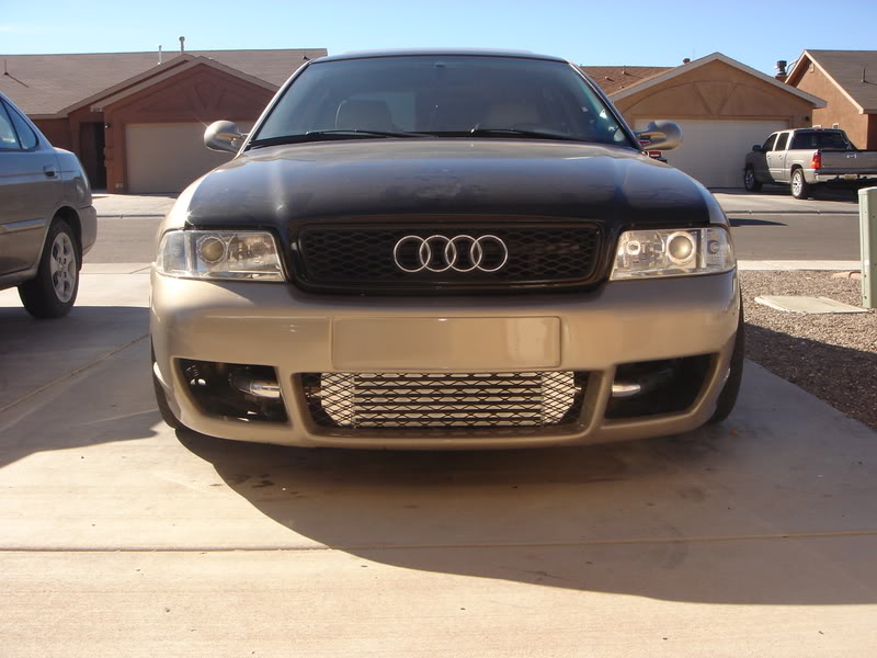

Mike is actually a very good source for the Racetec FMIC. I bought mine through him and he actually knows the owner of Racetec very well.
Here is a picture of it mounted behind my Reiger bumper. I used to have a GReddy fmic and this one actually fit a lot better behind my bumper. To fit my GReddy, I had to break off a few tabs on the rebar so that it would fit, but I do not think it would have been necessary on the Racetec. There are two different brackets you can order as one is designed for a stock bumper and the other is designed for an aftermarket bumper.
